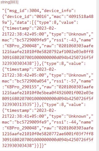

tried this but not decoding
{"msg_id":3004,"device_info":{"device_id":"0016","mac":"4091518a489a"},"data":[{"type":8,"value":{"timestamp":"2023-02-21T22:42:13+05:00","type":"Unknown","mac":"bc572900a054","rssi":-36,"name":"KBPro_290155","raw":"0201060303aafe1216aafe21010f0e5bea344943000f002e03f7091680207001000000000d094b4250726f5f323930313535"}},{"type":8,"value":{"timestamp":"2023-02-21T22:42:12+05:00","type":"Unknown","mac":"bc572900a046","rssi":-49,"name":"KBPro_290141","raw":"0201060303aafe1216aafe21010f0e5bf3e84fe0ffd2fbf9ffe1091680207001000000000d094b4250726f5f323930313431"}},{"type":8,"value":{"timestamp":"2023-02-21T22:42:11+05:00","type":"Unknown","mac":"bc572900a046","rssi":-41,"name":"KBPro_290141","raw":"0201060303aafe1216aafe21010f0e5bf3e84fe0ffc2fbf9ffd2091680207001000000000d094b4250726f5f323930313431"}}]}
Show us how you have set up your JSON node, you still have a string instead of a JavaScript object. @E1cid.'s suggestion only works on a JavaScript object.
Is there a question hidden there somewhere?
You need to select jsonata J: not string a/z. Also you have to input an object not a json (string)
