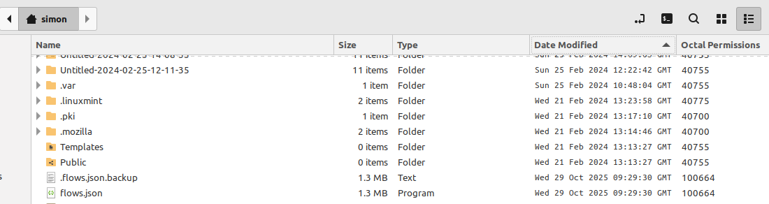

Progress!
I've found that my flows.json is being saved in my /home/simon folder instead of /home/simon/.node-red
I've found the issue
Turns out I don't manually start NR on this machine - I scripted it and got folder wrong!
#Plonker :slight_smile:
