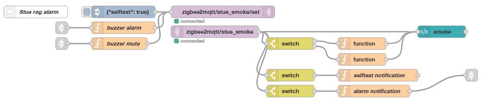

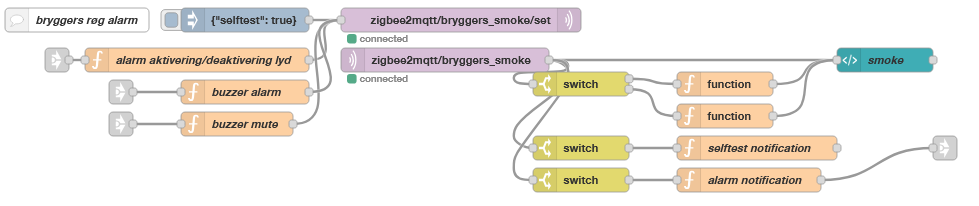

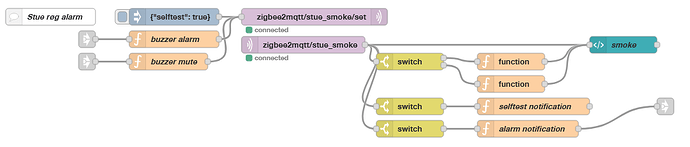

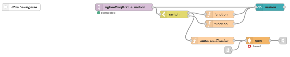

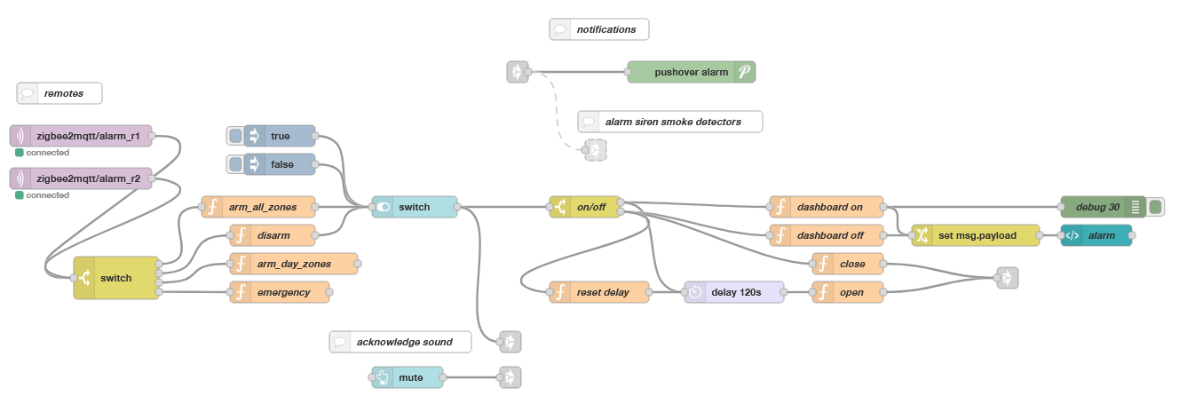

But got a working alarm system up and running:
main remotes and notifications
Smoke detectors & using them for alarm sirens too
motion
