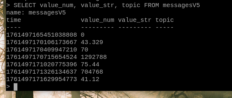

What I am trying to do is populate an Influx Database from a MQ_TT source and it works fine as long as everything is fields. My fields are value_num, value_str and topic. Topic will be populated by a string similar to "meteorcams/nz0014/starcount". As I said, this all works if all three are fields but I want topic to be a tag for indexing and sorting. But no matter what I have tried, the tag will not populate in the database. The function I am using is as follows:

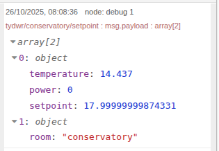

For example, this is what one of my messages looks like
Here's some screen dumps of what I have
You need to get it into the format I posted.

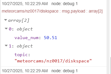

What does the output of the function node look like in a debug node?
Looks like it should
