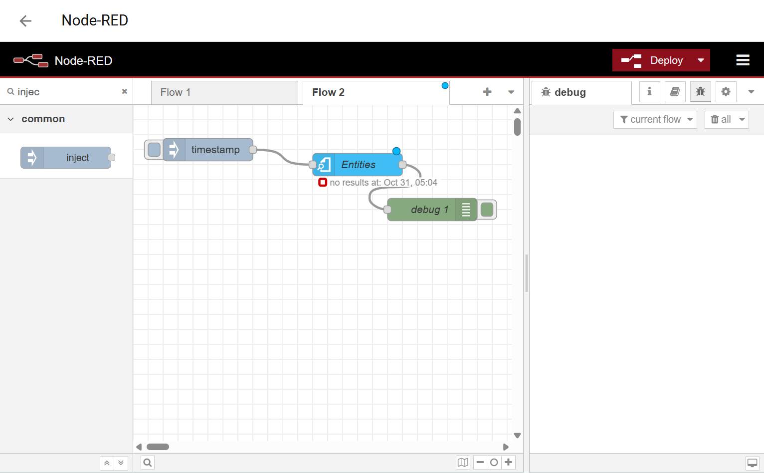

Kind of new to Node Red here. So I’m trying to poll multiple entities every 60 seconds using the “Get Entities” node on Node Red (running as an Add-On on Home Assistant) - I’m not sure what I’m doing wrong, all I see is “no results” (see attached screenshot)

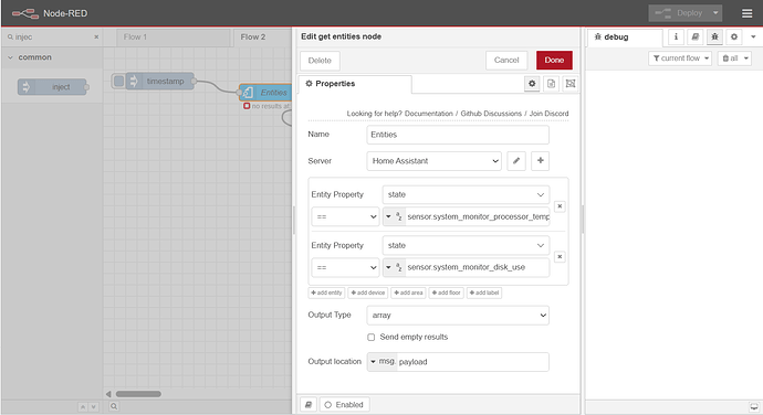

Here’s a screenshot of the get entities node:
Can someone please explain to me what I’m doing wrong here?

I don't use HA either but my interpretation of the node config is that you can get a list of "entities" whose "state" property matches what you have typed in.
So I'm guessing that nothing has a "state" of sensor.system_monitor_processor_temp, as that is the name of an entity not a state value, which likely should be a temperature, eg 40 degrees.
I don't have the node, but see what else other than state you can select, perhaps an entity id/name and then use a wild card to select multiple. Maybe contains "sensor.system_monitor_"
You could then filter the results to get the ones you want downstream.
It is rare for entities in home assistant to need to be polled. If you use those entities in an event state node, they will trigger whenever there is an update.
If you want to get the state of a particular entity at a certain time use the entity in a current state node. get entities is for finding entities e.g. find all door or window sensors that are reporting open.
You can find examples for the get entities node at the bottom of this page. You can find examples on how to use each node here.
Yes, I thought the same.
The funny thing is, the Entity Property field has no ‘entity_id’ option available in its list of selectable items. I can see state, last_changed, etc., but not any ‘entity_id’.
I see. So I infer there's no way to obtain entity state values.
I'm not sure where in the gui one enters the payload similar to the one at the bottom of the page. Don't know if HA's Node-red GUI allows for that

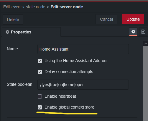

Since you already need to process the values, I would approach this through a function node. You can pull the state of an entity inside a function.
To get a state of an an entity
const hallwayLight = global.get('homeassistant.homeAssistant.states["switch.hallway"].state');
To get the attribute of an entity.
const cloudCover = global.get('homeassistant.homeAssistant.states["weather.openweathermap"].attributes.cloud_coverage');
Hit that with an inject inject every 30 seconds.

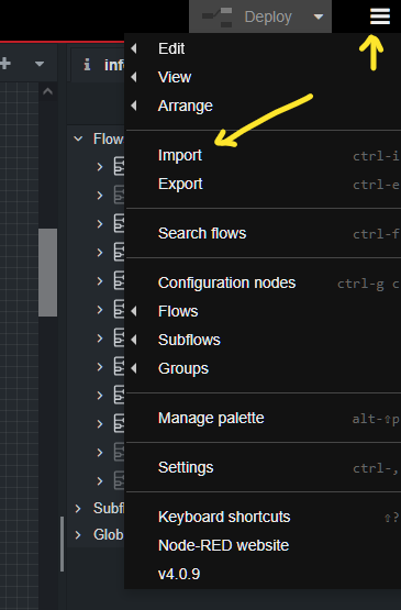

Edit: To import the json examples in the top right hamburger menu, choose import. Paste the json and click import.

I figured it out, thank you!! Function node it is!
One other thing, it's been so long since I started using NR, I can't remember if globals are enabled by default. Inside an ha node > server > pencil edit button
If it is not enabled, enable, restart NR, then restart HA
