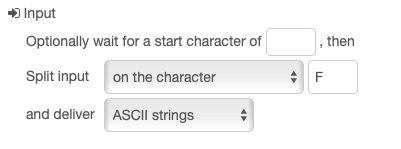

what happens if you do this?
But do note - you cant pass this output to moment - as its not a timestamp, it has many components, which wont parse to a date.
You're better of doing something like.

Thanks for the help Marcus, your suggestion worked and has led me to a workaround!
It appears to be an issue with waiting for the line end character - this never seems to trigger the delivery of a message by the node. Maybe it's an isolated issue for me but I have the same issue on two different computer and both serial adaptors and virtual COM ports. Anyway - a problem for another day!
