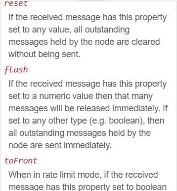

Sorry folks, but I went down a wrong track with the delay node and how to tell it to flush (dump?) all queued messages.
return {flush: 1} only sends the next message.
Is there a way to get it to dump all messages?

Ah!
Bit more reading.
return {flush: true} does what I want.
Sorry.
Yeah, well I read it but it didn't compute and I missed the latter part.
