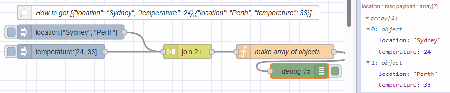

I think here, I would use a join to put both messages into the payload then a simple for loop in a function node.
Flow
[{"id":"e065d4d1e7c0eb23","type":"inject","z":"76a8eede6d0be0df","name":"","props":[{"p":"payload"},{"p":"topic","vt":"str"}],"repeat":"","crontab":"","once":false,"onceDelay":0.1,"topic":"location","payload":"[\"Sydney\", \"Perth\"]","payloadType":"json","x":990,"y":520,"wires":[["02fd63ee1b69d3f9"]]},{"id":"02fd63ee1b69d3f9","type":"join","z":"76a8eede6d0be0df","name":"","mode":"custom","build":"object","property":"payload","propertyType":"msg","key":"topic","joiner":"\\n","joinerType":"str","useparts":false,"accumulate":true,"timeout":"","count":"2","reduceRight":false,"reduceExp":"","reduceInit":"","reduceInitType":"","reduceFixup":"","x":1230,"y":560,"wires":[["b81ddba7b987a21f"]]},{"id":"6195c4d9beec1f9f","type":"inject","z":"76a8eede6d0be0df","name":"","props":[{"p":"payload"},{"p":"topic","vt":"str"}],"repeat":"","crontab":"","once":false,"onceDelay":0.1,"topic":"temperature","payload":"[24, 33]","payloadType":"json","x":970,"y":560,"wires":[["02fd63ee1b69d3f9"]]},{"id":"b81ddba7b987a21f","type":"function","z":"76a8eede6d0be0df","name":"make array of objects","func":"const data = msg.payload\nconst locations = data.location\nconst temperatures = data.temperature\n\nconst result = locations.map((location, index) => {\n    return {\n        location: location,\n        temperature: temperatures[index]\n    }\n})\n\nmsg.payload = result\nreturn msg\n","outputs":1,"timeout":0,"noerr":0,"initialize":"","finalize":"","libs":[],"x":1430,"y":560,"wires":[["e274243f93ae035d"]]},{"id":"e274243f93ae035d","type":"debug","z":"76a8eede6d0be0df","name":"debug 15","active":true,"tosidebar":true,"console":false,"tostatus":false,"complete":"false","statusVal":"","statusType":"auto","x":1460,"y":600,"wires":[]}]
Function code only
    return {
        location: location,
return msg
Thanks Steve.
