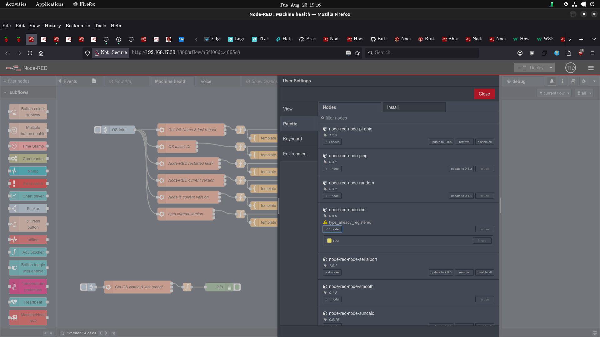

Help with update. RBE type already registered
Node.js version v18.20.6
NPM version 10.8.2
O/S and last reboot Raspbian GNU/Linux 10 (buster)
2025-06-05 21:55:47
O/S install DT
Node-red last started Mon 2025-08-25 19:57:07 AEST
N/R version 4.0.9
Sorry, but what do I need to do?
Go into your .node-red folder and run
npm remove node-red-node-rbe
and restart node red and refresh the browser.
You don't need it any more as it is included in core as the filter node. Your flows will not be affected.
