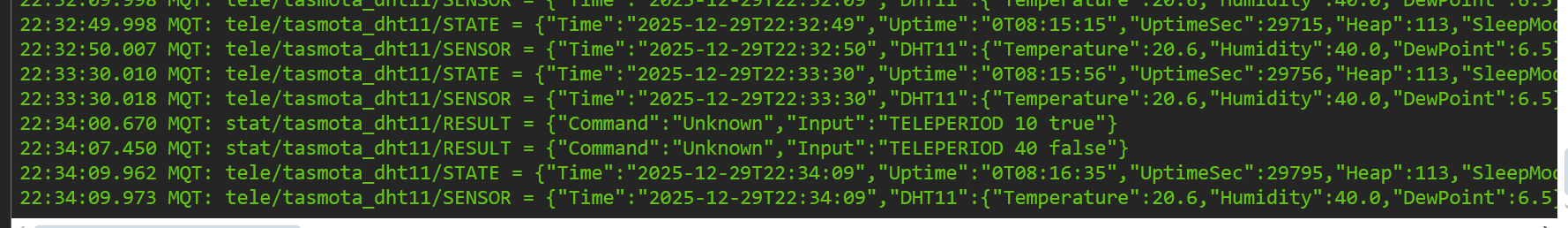

and the response in tasmota

Making a educated guess here, I presume teleperiod is the command and 10 and 40 are the value.
Try setting cmnd/tasmota_dht11/TelePeriod as the topic, and set msg.payload to 10 or 40 after the switch node, using a change node on each wire.

worked great thanks.
