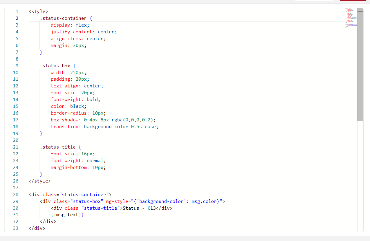

How can I change the color of a template by injecting the desired color through msg.payload?
the layout is:
inject -> http request -> funktion -> template
I want the color to change based on whether it is connected or not. But no matter what I try, I am not able to "inject" a color into the template. Please help me figure out a way to do this. I am not proficient in coding and have mostly been using AI to write my code. Thank you in advance.

Welcome to the forum @Overpago
No doubt you have discovered that you can include msg.text in the template content using 'mustaches', eg
<p>{{msg.text}}</p>
The syntax for styling an element <div style = "yellow"> ... is different.
Try
<div :style="{'background-color' : msg.color}">
Note the colon before 'style'.
Welcome. You may need to specify that the template is for Dashboard 2 if using AI as ng-style I think is Dashboard (1).
