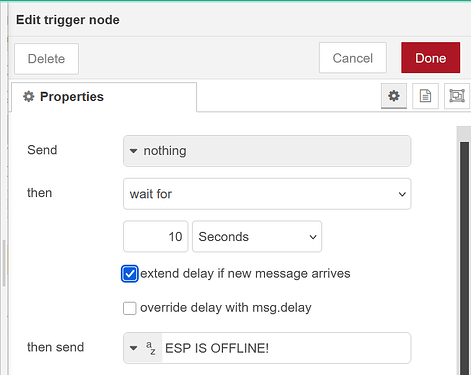

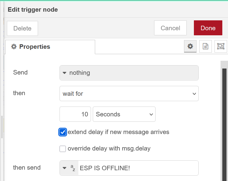

In Node-red you only need a trigger node to respond to loss of the heartbeat:

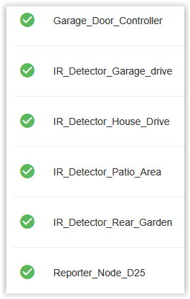

:white_check_mark: Don’t forget HealthChecks (HC)
It’s really simple to set up and comes with lots of useful features:
  • The free tier lets you monitor up to 20 jobs.
  • Setup is straightforward: each job is assigned a unique URL, and you just send a simple HTTP request (a “ping” or "heartbeat") to confirm everything is running.
  • The HC dashboard lets you configure grace periods, schedules, and notification preferences.
I use HC to monitor a set of ESP32-S2-Mini nodes written in MicroPython. But you don’t need MicroPython specifically—since all HC needs is a simple HTTP request, it works with nearly any language or environment.
For notifications, HC supports many integrations. I personally use email and Telegram, but Slack, Discord, and other options are available as well.
