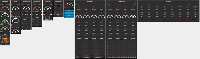

on the left picture I have 2 headers. The first header on top is the name of the group. Unfortunately I forgot to disallow group name. How can I get rid of this header. Should look like on the second group. On this group I had switched show header off which is what I want.

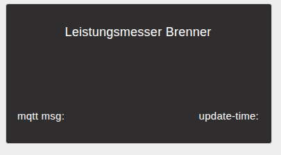

For me that looks like
if you put it into a page as a group.
name the group Leistungsmesser Brenner
allow show group name.
deploy
what happens then?
you should see the name of the group and the same text below

Disconnect the wire going into the UGHZ-Leistungsmesser text node. I suspect you are seeing the label and the value for that node.
Hi Colin,
i found the problem. Silly mistake from myself. I had the lable set in in text node and then send the same text from the intialisation routine.
Many thanks for your support.
Now it is perfect
