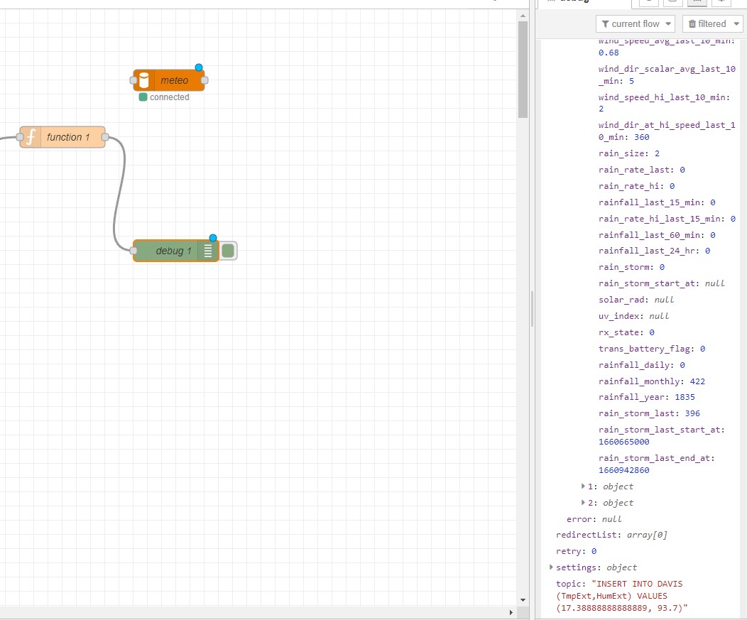

if i put a debug and it work well. i find my complete payload appear and also test values from @jbudd request.
Are you sure about this ?
Looking at the screenshot: affected rows: 1
