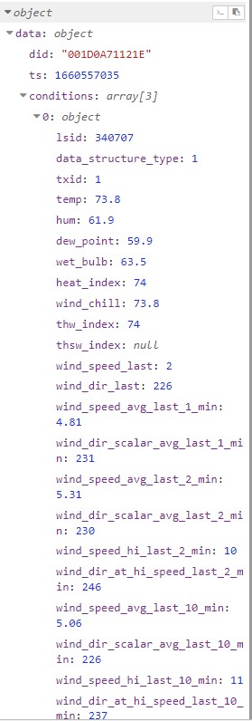

i just created a new database and i'd like to insert data coming from a "http Request "that output is a parsed json object but i d on't know how to doCan you help me insert these data ?
i created my sql node and connect is ok. but after i dont know what to do
Assuming that it's a MySQL or Mariadb database, you need something like this, maybe in a function.
msg.payload = {temp: msg.payload.data.conditions[0].temp, hum: msg.payload.data.conditions[0].hum};
msg.topic = "INSERT INTO tablename (temp, hum) VALUES(:temp, :hum)";
Obviously use the proper table and field names.
You can get the right path for each data value from the debug panel "Copy path" button.
