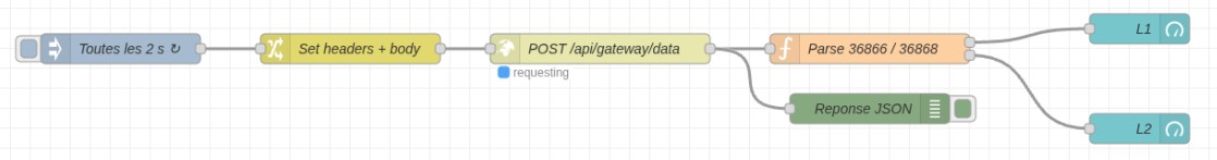

Can you show a screen shot of the nodes config
Here is my nodes config
Sean meant that you open one of the gauge nodes and show us how it is configured.

Here are the screenshots showing my gauge configuration and how it looks on the dashboard.
