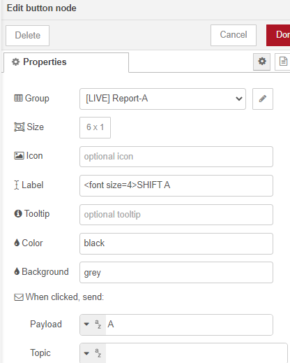

Can You Please tell me one more thing as, I want to increase font size in dashboard.
How can I do that?
you should use template node for the dashboard, CSS is not my forte, however minimal adjustment we can try using <font size> in the 'ui_text' or 'ui_button' widgets.
please share your flow
