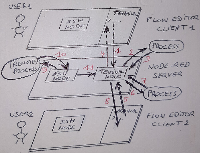

Hey @sudoritz,
Although I find your idea intriging, I don't think it is possible.
Will try to explain how the xterm (node) works.
Suppose two users are running a flow editor session, to interact with a Node-RED server:
  1. User 1 enters a character (to enter a command), which will be send via an ajax call to the Node-RED server.
  2. That character will be send to the (linux/windows/...) process which is reserved for that flow editor session (by the xterm node).
  3. That character will be send back to the xterm node.
  4. That character will be send (via websocket channel) back to the flow editor, where you will see it appear. Some notes:
    • So the character has done an entire roundtrip to the OS process and back to the browser, before you see it appear!!
    • As soon as an entire command has been entered, the process will also send the output (i.e. the result of the command) to the flow editor (via steps 4 and 5).
    • The xterm node will see to which flow editor session the characters (input/output) belong, to make sure that multiple users can work simultaneously in separate sessions (without the content being mixed): see steps 5 to 8.
However what you want to do:
a) Inject a message to the Node-RED server
b) That message travels on the Node-RED server between the nodes.
c) You connect via an ssh node to a remote process to send a command (step 9)
d) Then you get a result from that session (step 10)
e) And then you send that result to my node (step 11).
f) Suppose my xterm node would have an input, it would receive characters. But it has no idea which node originally has triggered the inject button. So it won't know where to send the characters, which means that both flow editors would show the characters.
And when you enter characters in the xterm terminal, then - suppose my xterm node should have an output - those characters should be send to the output, and wired again to the ssh node. But you wouldn't see your own letters appear, since I get no data back from the next node in the flow.
I hope you see that the xterm concept doesn't really fit your idea...
