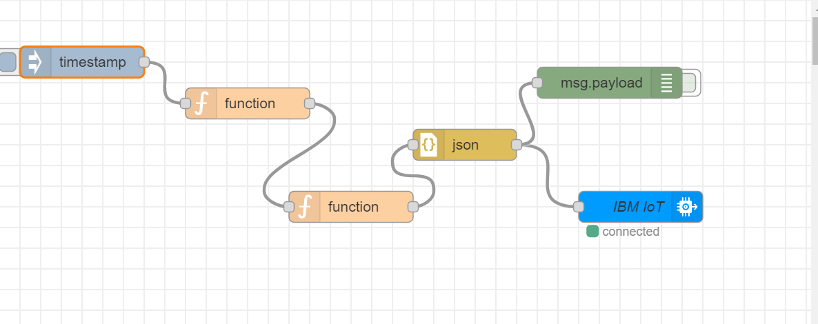

Hi, Sorry for asking a silly question. But I am a super beginner at node-red and trying my best to learn something.
I want to have a function that slowly increases the value to 100 (I want that value to pass to IOT device continuously.)
Like initially 1, then after 1 sec:2, after 1 sec:3 ..... like that, until 100. All values should be continuously sent to IOT device.
How can I do this? Any help/resources will be super helpful.
Thank you so much!!
