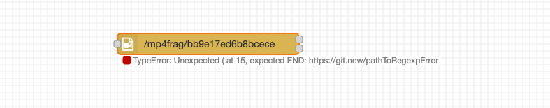

When I installed the node, everything seems to be ok but when I add the node to the flow, I get an error message as below. I have tried to search the net to find the reason behind but with no success. Does anyone know if this is a node or a Node-RED issue I have stumbled upon?
The same node works fine in a RPi so I wonder if it could be because the NVIDIA has the aarch64 archtecture?
"TypeError: Unexpected ( at 15, expected END: https://git.new/pathToRegexpError"

This is your issue. Changes in express 5 and it's sub dependency path-to-regexp
As far as I can see, Kevin's node did not explicitly request express but it is a peer dependency. When this node was created express was at v4.
You could try npm remove express path-to-regexp followed by npm i express@4 (path-to-regexp v8.0 will be installed by express)
