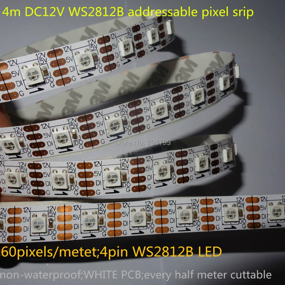

OK. So aliexpress then. Here you go: https://www.aliexpress.com/item/32981318078.html?spm=a2g0o.productlist.0.0.73f626eeXUQ1c1&algo_pvid=f96bbcb5-3f56-46ec-a5c4-480c26c12e6a&algo_expid=f96bbcb5-3f56-46ec-a5c4-480c26c12e6a-2&btsid=0b0a050b15988558814332399ecd6d&ws_ab_test=searchweb0_0,searchweb201602_,searchweb201603_

You can, however, get 12v neopixel strips.
And even 24V ones.
https://www.gree-leds.com/led-addressble-pixel/24v-5leds-rgb-ws2801-pcb.html
The biggest difference between them - apart from @ristomatti's comments is that you will need to provide power more regularly along the strip in order to get even lighting. The power drop mentioned also happens along the length of the strip. So typically, a 12v strip needs power about every 5m, a 24v strip maybe every 7m or so. Otherwise you will notice that the brightness drops (on white LED's) and/or the colour shifts on RGB LED's (because the 3 elements inside do not give equal brightness and we do not perceive different colours with equal brightness). The other difference is that, since power supplies are fixed voltage but have a max amperage, you can drive more LED's with a single power supply when using 24v.
