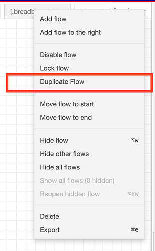

I've added a menu option for this, not realising that cmd-a, cmd-c, plus icon, cmd-v was a thing:
It basically follows the path as how lock-flow and disable-flow are implemented, i.e., defining an action that is called when the menu item is selected.
For the actual "work", I defined the duplicateWorkspace function:

that's a hack-together function that best solved the problem of copy and replacing ids for an existing flow.
Just an idea for those that might like this.
Why? Because I spend a lot of time creating small flows that I copy and then extend ...
This is well done, but why enable touchImport?
what does that even do? I don't know :slight_smile:
I admit it, I added the feature, it worked, nothing broke and I moved on! The touchImport just looks nice there at the end ....
