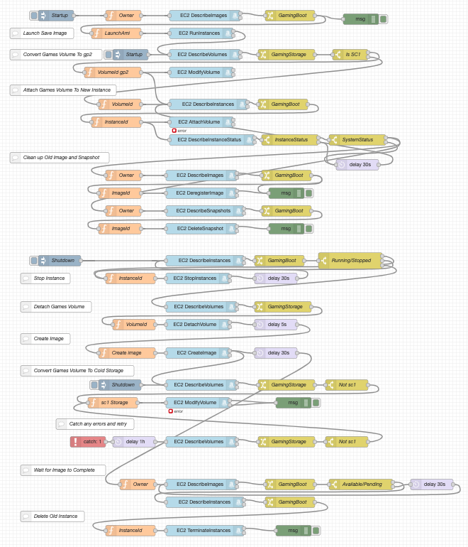

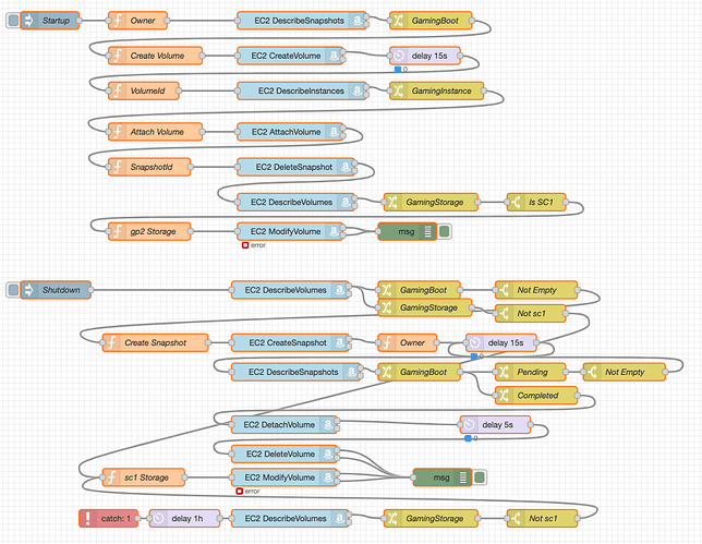

I setup these flows to create, modify, and delete my volumes and snapshots for minimal billing.
I'm using a g4dn instance for cloud gaming with Parsec.
It does almost everything. I'm choosing to manually start and stop my instance but that could easily be automated as well.
I used Tags to make sure I select the right thing to modify.
flows.json (64.6 KB)
I went a bit down the wrong track with my root volume. Should have created an image (AMI).
Here's my updated flow.
AWS EC2 cloud gaming.json (102.7 KB)
