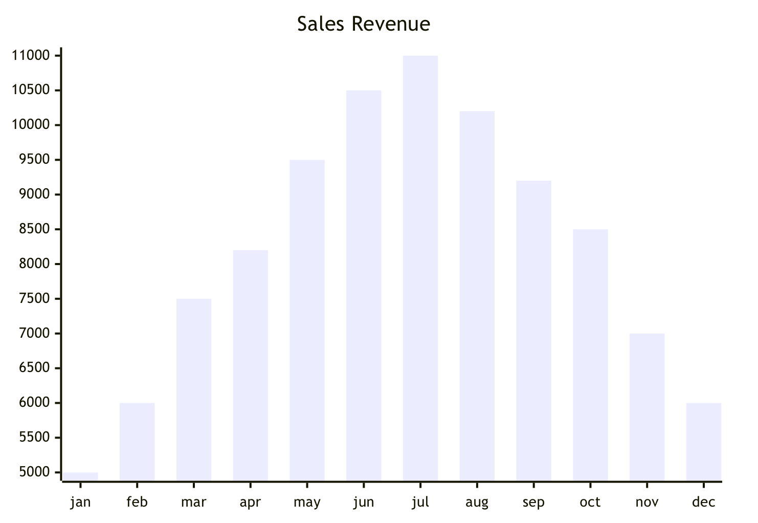

Keep in mind that the markdown node has full support for mermaid, which makes (flow)charting etc very simple. Even a simple bar chart can be made with some text only, ie:
``` mermaid
xychart-beta
    title "Sales Revenue"
    x-axis [jan, feb, mar, apr, may, jun, jul, aug, sep, oct, nov, dec]
    bar [5000, 6000, 7500, 8200, 9500, 10500, 11000, 10200, 9200, 8500, 7000, 6000]
renders:

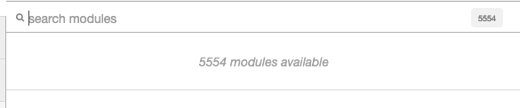

Btw2:
Who's going for node package 5555?
