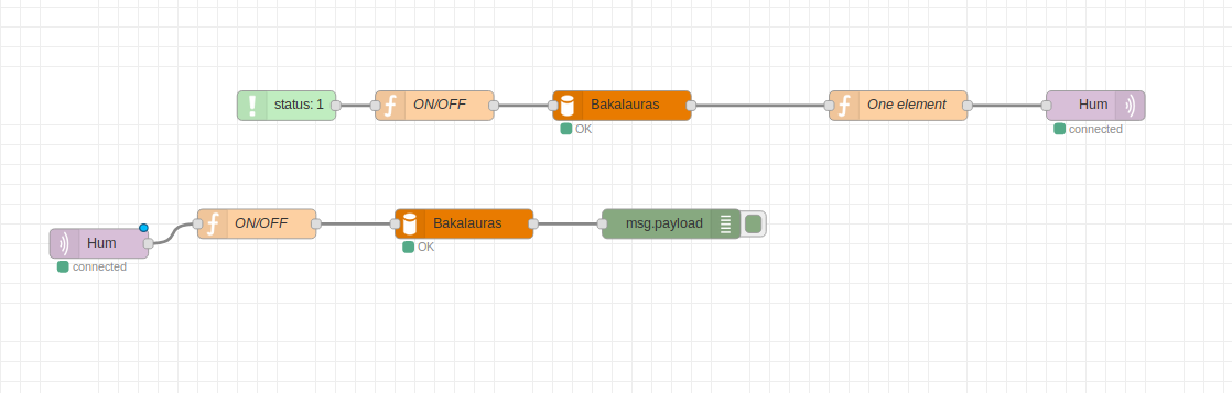

Hello,
I'm using MIT app inventor to publish data to MySQL database and from MySQL database to my MQTT broker. Everything is working fine but as soon as I send data from my phone, this data loops every second and never stops on MQTT Broker. What i'm creating is a smoke detector which will beep if it detects smoke, if i trigger off switch it will send it to MQTT Broker to turn it off, but it keeps telling MQTT Broker to turn it off, in case there is a fire next time, smoke detector will be shut down immediately because messages that get published are looping. What can I do to read only new data that comes to MySQL database once?
Please help
