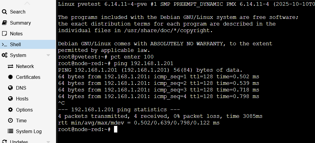

Since you have node-red running in a container, this is likely a networking issue.
Try installing node-red-node-ping and ping the modbus IP from within node-red to verify whether it has connectivity.
ping is ok.

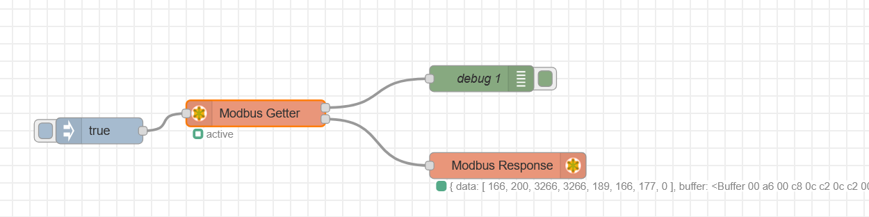

ok, works now
The gateway was misconfigured. Thanks, you made me redo the entire configuration.
