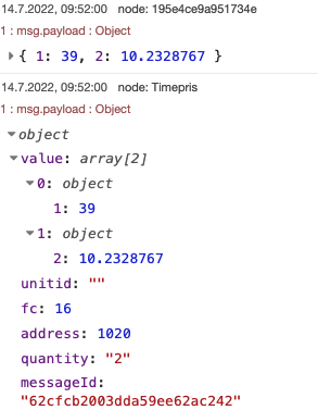

So I have made this and put two values into a modbus node. It is important that these values do come in the same order each time. What can I do to get it right?
The values from the array now looks like this:
fasteavgifter : msg.payload : Object
object
value: array[2]
0: 30
1: 10.2328767
unitid: ""
fc: 16
address: 1020
quantity: "2"
messageId: "62cf3ca003dda59ee62a6954"
The solution is to not use array mode in the join node. Use object key val mode.
Make sure the 2 items to join have individual topics before they enter the join node. After the join node you will see the two values are always in the same named items within the payload. You can then arrange these in an array if you need to.
Yes, you have told me that before. I have been looking into it, and tried it, but I didnt get it to pass the modbus write node. So for now I have just delayed the second message with 10ms.
Did you use a debug output to check what was coming out of the join node??
Did you rearrange the object to make an array before you send it to the modbus node?
Adding a delay is an ugly hack (sorry). If ever one of the messages are delayed by more than 10 seconds, you will have a similar problem
The output was like 1:29,95, 2: 10,2125
Or something like that. Sorry for my maybe dumb question, how do I make an array out of that.
I know delay isnt a good thing but in this case the two values are initiated by two cronplus nodes so I hope that will work until I solved it the best/correct way.

@FSHelgeland
A function node with
msg.payload = [ msg.payload["1"], msg.payload["2"] ]
return msg
will give you an answer of [39, 10.2328767] (i.e. an array of numbers instead of an array of objects) - is that not what you really need?
Yes it is, just discovered that 5 seconds ago, was searching for that solution now. Happy you were ahead of me.
