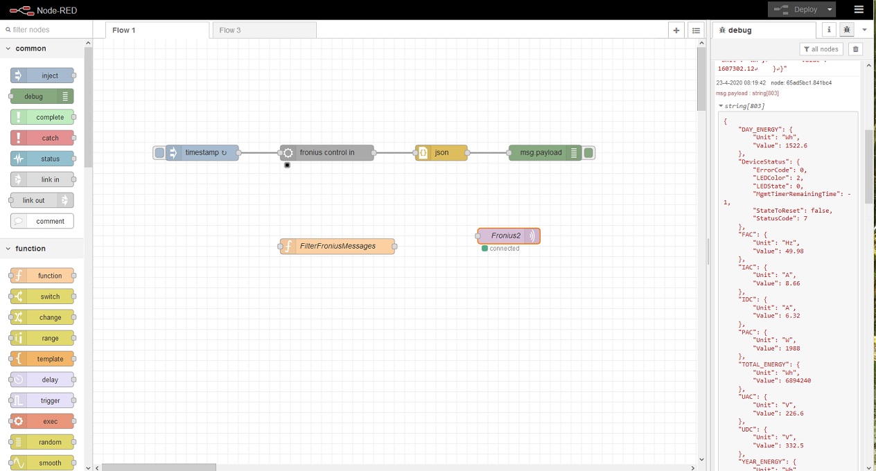

These are the nodes and debug window:
The string as I posted it is from the debug window attached to fronius-control-in. Hope you can help! Like to learn this (a bit).

can you show us a picture of what comes straight out of the fronius node when you connect a debug to it? Maybe you dont need the json node.
And think again, its not an array. There is a difference between an array and an object. You will have to work with object keys and not array indexes. Its all in the link I posted to the documentation.
Edit: just to clarify is the output we see in the debug window from the debug attached to the json node or is this from when the debug was connected directly to the fronius node?
This is the output then in the debug window.
debug-2
and expanded:
I'm sorry, my thoughts on the msg.payload[0] were in general. Not for this string, this one first needs to be json to work with it.
To the right is where I click to see the debug messages. Do correct me if I'm wrong.
No this is already an object you can work with no json node needed. Please read the section on understanding the structure of a message here https://nodered.org/docs/user-guide/messages
When you have done this you should have all the tools to figure it out.
But to repeat it:
You have a object and not an array your working with. So msg.payload[0] cant work as its an array reference. You will have to use something like msg.payload.DAY_ENERGY. Objects have keys and arrays have indexes.
If you hover over one of those in the debug tab like DAY_ENERGY it will give you little icons on the side and one of them will give you this path.
This is all explained in the documentation i posted the link to including a link to further information about javascript object types https://developer.mozilla.org/en-US/docs/Web/JavaScript/Data_structures.
Thanx for pointing me in the right direction! I will do that.
Thank you so much! Got it working with a change node. Now I can add the needed info into the original object! So simple....
