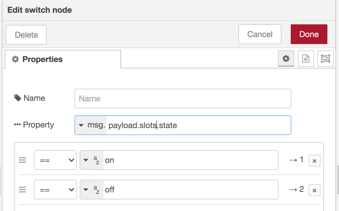

You don't need a function for that... A switch node is your friend:
As you don't describe what you want to do with the various values of "pin" it is difficult to describe it further...
But, you could use a switch as well for the "pin" values.
GV
Hi Hugo, @greengolfer is correct in that you can achieve this with builtin switch and change nodes.

Dear greengolfer,
Could you send me a flow with that node only. I can't figure out how to get "···Property" below Name.
I see "Rules" instead.

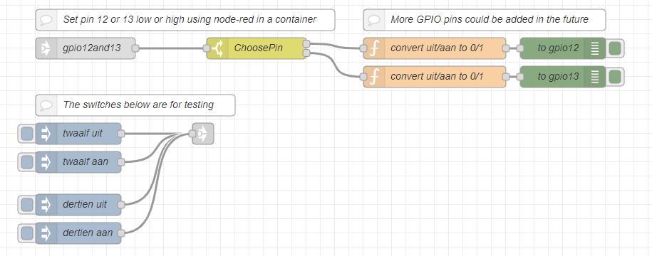

What I really want is that depending on the pin number which is coming through, a 0 or a 1 should be sent to a gpiod-output. Checking whether the pin is available is only a safety measure. So I thought a switch node might be useful (or a function with more than 1 output, 2 if only pin 12 and 13 are used, but in the future there will be more) . I have added a flow which shows the idea using a switch (note however the switch is not configured correctly, I don't know how).

Try this...
[{"id":"918eee3e.d731c","type":"comment","z":"eec6199a.e09fb8","name":"Set pin 12 or 13 low or high using node-red in a container","info":"","x":290,"y":100,"wires":[]},{"id":"5a0b30ab.cb57c","type":"link in","z":"eec6199a.e09fb8","name":"gpio12and13","links":["b3728467.3ab1","7a401449.e0613c","1d070139.b9491f"],"x":150,"y":140,"wires":[["e2a0d79.2366f28"]],"l":true},{"id":"e839ac74.072b8","type":"comment","z":"eec6199a.e09fb8","name":"More GPIO pins could be added in the future","info":"","x":710,"y":100,"wires":[]},{"id":"e2a0d79.2366f28","type":"switch","z":"eec6199a.e09fb8","name":"ChoosePin","property":"payload.slots.pin","propertyType":"msg","rules":[{"t":"eq","v":"dertien","vt":"str"},{"t":"eq","v":"twaalf","vt":"str"}],"checkall":"true","repair":false,"outputs":2,"x":390,"y":140,"wires":[["f6b8e34b.a1b02"],["6c4d2f6c.a711d"]]},{"id":"bad57987.18bb68","type":"comment","z":"eec6199a.e09fb8","name":"The switches below are for testing","info":"","x":220,"y":220,"wires":[]},{"id":"9c1a5e3b.c9103","type":"inject","z":"eec6199a.e09fb8","name":"twaalf uit","topic":"","payload":"{\"entities\":[{\"end\":11,\"entity\":\"pin\",\"raw_end\":11,\"raw_start\":4,\"raw_value\":\"dertien\",\"start\":4,\"value\":\"dertien\",\"value_details\":{\"kind\":\"Unknown\",\"value\":\"dertien\"}},{\"end\":15,\"entity\":\"state\",\"raw_end\":15,\"raw_start\":12,\"raw_value\":\"uit\",\"start\":12,\"value\":\"uit\",\"value_details\":{\"kind\":\"Unknown\",\"value\":\"uit\"}}],\"intent\":{\"confidence\":0.6666666666666667,\"name\":\"gpio12and13\"},\"raw_text\":\"zet pin dertien uit\",\"raw_tokens\":[\"zet\",\"pin\",\"dertien\",\"uit\"],\"recognize_seconds\":0.16175900300004287,\"slots\":{\"pin\":\"twaalf\",\"state\":\"uit\"},\"speech_confidence\":1,\"text\":\"zet dertien uit\",\"tokens\":[\"zet\",\"dertien\",\"uit\"],\"wakeword_id\":null}","payloadType":"json","repeat":"","crontab":"","once":false,"onceDelay":0.1,"x":140,"y":260,"wires":[["7a401449.e0613c"]]},{"id":"7a401449.e0613c","type":"link out","z":"eec6199a.e09fb8","name":"","links":["5a0b30ab.cb57c"],"x":315,"y":260,"wires":[]},{"id":"88807acb.d52bd8","type":"debug","z":"eec6199a.e09fb8","name":"to gpio12","active":true,"tosidebar":true,"console":false,"tostatus":false,"complete":"payload","targetType":"msg","x":820,"y":140,"wires":[]},{"id":"ef3e044a.a3b698","type":"debug","z":"eec6199a.e09fb8","name":"to gpio13","active":true,"tosidebar":true,"console":false,"tostatus":false,"complete":"payload","targetType":"msg","x":820,"y":180,"wires":[]},{"id":"3c70687d.e647d8","type":"inject","z":"eec6199a.e09fb8","name":"twaalf aan","topic":"","payload":"{\"entities\":[{\"end\":11,\"entity\":\"pin\",\"raw_end\":11,\"raw_start\":4,\"raw_value\":\"dertien\",\"start\":4,\"value\":\"dertien\",\"value_details\":{\"kind\":\"Unknown\",\"value\":\"dertien\"}},{\"end\":15,\"entity\":\"state\",\"raw_end\":15,\"raw_start\":12,\"raw_value\":\"uit\",\"start\":12,\"value\":\"uit\",\"value_details\":{\"kind\":\"Unknown\",\"value\":\"uit\"}}],\"intent\":{\"confidence\":0.6666666666666667,\"name\":\"gpio12and13\"},\"raw_text\":\"zet pin dertien uit\",\"raw_tokens\":[\"zet\",\"pin\",\"dertien\",\"uit\"],\"recognize_seconds\":0.16175900300004287,\"slots\":{\"pin\":\"twaalf\",\"state\":\"aan\"},\"speech_confidence\":1,\"text\":\"zet dertien uit\",\"tokens\":[\"zet\",\"dertien\",\"uit\"],\"wakeword_id\":null}","payloadType":"json","repeat":"","crontab":"","once":false,"onceDelay":0.1,"x":140,"y":300,"wires":[["7a401449.e0613c"]]},{"id":"3b5eb17.7da884e","type":"inject","z":"eec6199a.e09fb8","name":"dertien uit","topic":"","payload":"{\"entities\":[{\"end\":11,\"entity\":\"pin\",\"raw_end\":11,\"raw_start\":4,\"raw_value\":\"dertien\",\"start\":4,\"value\":\"dertien\",\"value_details\":{\"kind\":\"Unknown\",\"value\":\"dertien\"}},{\"end\":15,\"entity\":\"state\",\"raw_end\":15,\"raw_start\":12,\"raw_value\":\"uit\",\"start\":12,\"value\":\"uit\",\"value_details\":{\"kind\":\"Unknown\",\"value\":\"uit\"}}],\"intent\":{\"confidence\":0.6666666666666667,\"name\":\"gpio12and13\"},\"raw_text\":\"zet pin dertien uit\",\"raw_tokens\":[\"zet\",\"pin\",\"dertien\",\"uit\"],\"recognize_seconds\":0.16175900300004287,\"slots\":{\"pin\":\"dertien\",\"state\":\"uit\"},\"speech_confidence\":1,\"text\":\"zet dertien uit\",\"tokens\":[\"zet\",\"dertien\",\"uit\"],\"wakeword_id\":null}","payloadType":"json","repeat":"","crontab":"","once":false,"onceDelay":0.1,"x":140,"y":360,"wires":[["7a401449.e0613c"]]},{"id":"af4d581b.bb0588","type":"inject","z":"eec6199a.e09fb8","name":"dertien aan","topic":"","payload":"{\"entities\":[{\"end\":11,\"entity\":\"pin\",\"raw_end\":11,\"raw_start\":4,\"raw_value\":\"dertien\",\"start\":4,\"value\":\"dertien\",\"value_details\":{\"kind\":\"Unknown\",\"value\":\"dertien\"}},{\"end\":15,\"entity\":\"state\",\"raw_end\":15,\"raw_start\":12,\"raw_value\":\"uit\",\"start\":12,\"value\":\"uit\",\"value_details\":{\"kind\":\"Unknown\",\"value\":\"uit\"}}],\"intent\":{\"confidence\":0.6666666666666667,\"name\":\"gpio12and13\"},\"raw_text\":\"zet pin dertien uit\",\"raw_tokens\":[\"zet\",\"pin\",\"dertien\",\"uit\"],\"recognize_seconds\":0.16175900300004287,\"slots\":{\"pin\":\"dertien\",\"state\":\"aan\"},\"speech_confidence\":1,\"text\":\"zet dertien uit\",\"tokens\":[\"zet\",\"dertien\",\"uit\"],\"wakeword_id\":null}","payloadType":"json","repeat":"","crontab":"","once":false,"onceDelay":0.1,"x":140,"y":400,"wires":[["7a401449.e0613c"]]},{"id":"f6b8e34b.a1b02","type":"function","z":"eec6199a.e09fb8","name":"convert uit/aan to 0/1","func":"const stateLookup = {\"aan\":1, \"uit\":0};\nmsg.payload = stateLookup[msg.payload.slots.state];\nreturn msg;","outputs":1,"noerr":0,"x":640,"y":140,"wires":[["88807acb.d52bd8"]]},{"id":"6c4d2f6c.a711d","type":"function","z":"eec6199a.e09fb8","name":"convert uit/aan to 0/1","func":"const stateLookup = {\"aan\":1, \"uit\":0};\nmsg.payload = stateLookup[msg.payload.slots.state];\nreturn msg;","outputs":1,"noerr":0,"x":640,"y":180,"wires":[["ef3e044a.a3b698"]]}]
Thanks, works nicely and I learned a lot.
