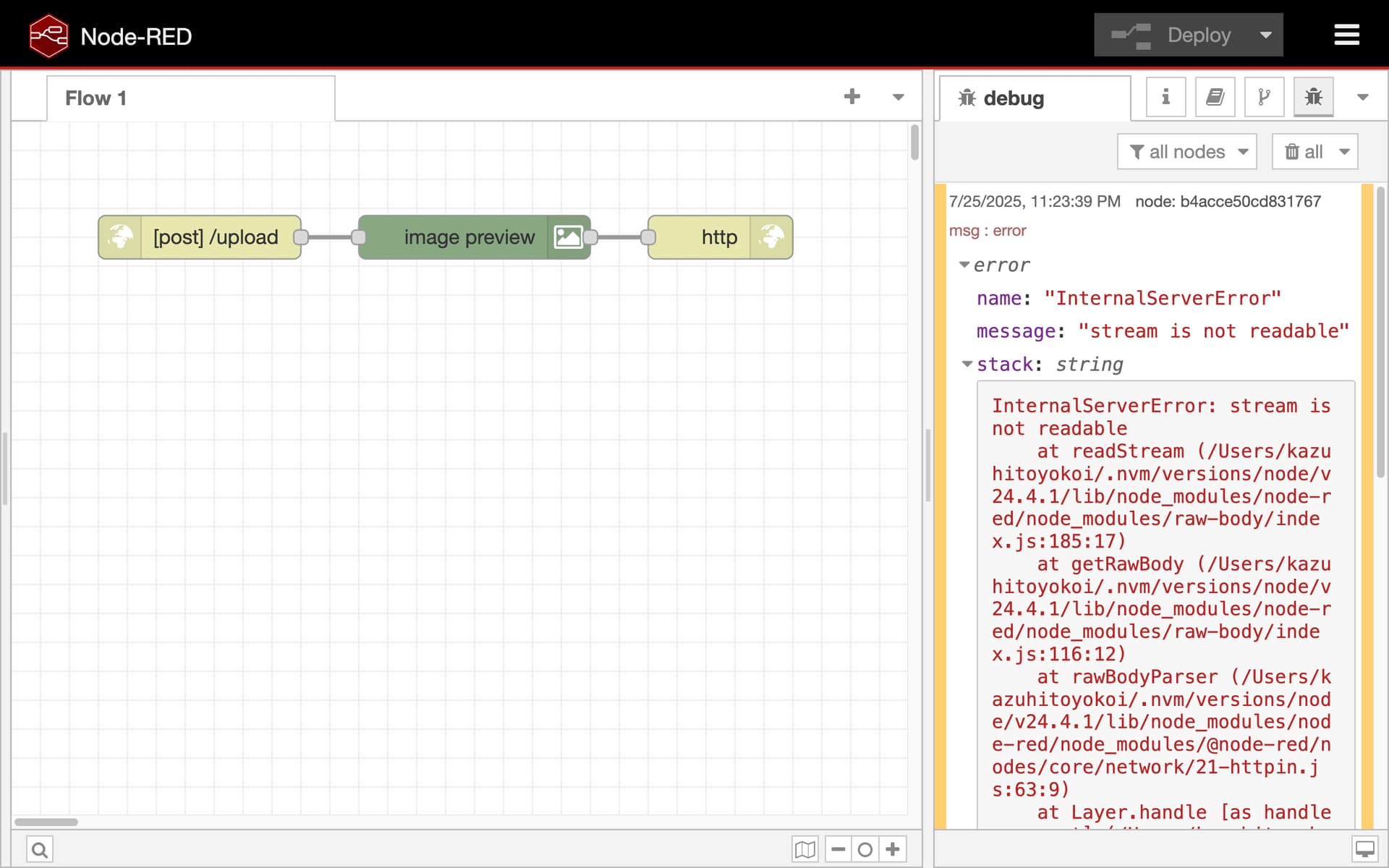

When I tried this beta, I found that file upload using the http-in node fails. In v4.0.9, it works.
File upload command
curl -X POST http://localhost:1880/upload -F "file=@node-red-icon.png"
Node-RED flow
[{"id":"b4acce50cd831767","type":"http in","z":"cda04605a4c46de8","name":"","url":"/upload","method":"post","upload":true,"swaggerDoc":"","x":130,"y":80,"wires":[["2c244bcab8038c09"]]},{"id":"cc26d7e4122552f5","type":"http response","z":"cda04605a4c46de8","name":"","statusCode":"","headers":{},"x":490,"y":80,"wires":[]},{"id":"2c244bcab8038c09","type":"image","z":"cda04605a4c46de8","name":"","width":160,"data":"req.files[0].buffer","dataType":"msg","thumbnail":false,"active":true,"pass":true,"outputs":1,"x":320,"y":80,"wires":[["cc26d7e4122552f5"]]},{"id":"7206c40ade6541a2","type":"global-config","env":[],"modules":{"node-red-contrib-image-output":"0.6.4"}}]

Yes, I'm using Node.js v24.4.1 on macOS. Using the latest dev branch, the situation is the same as the 4.1.0-beta.2.
I also tried Node.js v22.17.1 for dev branch and 4.1.0-beta.2 but all my tests failed.
Just pulled dev branch, ran npm install, imported your flow...
Before executing curl command, you need to download the png file in advance. In v4.0.9, curl command returns {}. In 4.1.0-beta.2, curl command returns Internal Server Error.

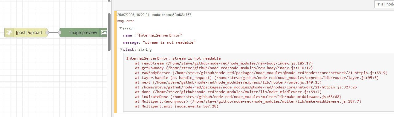

Ah, yes, I should have supplied an actual image (i assumed it would make no difference :man_facepalming:) but alas, yes, I see the same issue now:
Can you please raise an issue?
Thank you for reproducing the error. I submitted the GitHub Issue.
