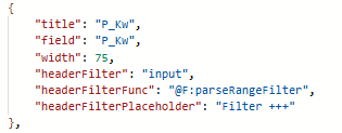

I would like to know if it’s possible to create a filter like that : (Min - Max)
with the current version of dashboard-2-table-tabulator ? I can reproduce the same result with the actual tbCmd currently available to interact with the node. However this solution is not part of the “persistence” option I use for the other filters, which makes management a little bit tricky (for me :wink: ). If it’s possible, would you have a exemple of how to implement this filter ?

The custom filter itself can be easily implemented as a custom function in the node configuration.
A simple solution would then be an input field taking a string in a format such as <min>-<max> (like page range selection in a print dialog), and parse it in the custom filter.
How did you create the filter UI (in the screenshot you provided)?. Is there a built-in feature for this which I'm not aware of, or some dynamic HTML trickery?
As for persistence, it is handled internally by tabulator and the browser, the node has no involvement or control over it (besides whatever is exposed by the tabulator API).

The picture I used to explain ma question came from the Tabulator website (in the exemple folder). I took the Min - Max exemple just because I had two parameters to enter for my filter (field : not needed because it’s for one column only, type and value. I creeate the function like you explain to me, with the option: <, <=, >, >=, like, x - y (range). And with this solution I keep filter “presistence”.
Here is the result.
