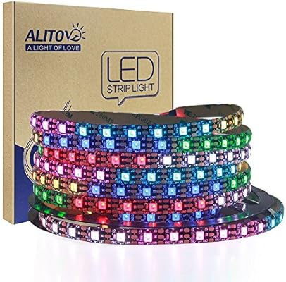

to control this strip-
I set the wipe time to 0 MS (on the setting of the neopixle node) The 300 LED strip is now very very fast.
I'm having a weird thing with each end of the light. the start of the strip is the correct color but the far end is not. If I tell it to do all R or G or B the colors look fine but a blend gives me a different color from one side to the other. Here is a pic of the strip just trying to white-
It also looks funny with other colors, if I try to do a green it looks washed out, a yellow and it goes red at the end.

You may be having too large a voltage drop along the strip. Its description on Amazon refers to "separate power/ground wires on both ends for injecting power in case of voltage drop."
