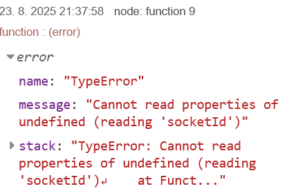

maybe I am doing some things wrong, but :
In function :
msg.payload=msg._client.socketID;
Doesn’t work at this moment. If you change Inject node with button with equal conditions, that is OK, and generate correct socketId.
Why Inject node has no possibility to generate loop for “socketId” ?
Is there a next bug, or no ??

Wire the UI Event node as the first node in your flow. The socketID is generated from the browser event. Whenever someone views your Dashboard, the UI Event emits a “pageview” message.
Within that message will be msg._client
Your function nodes is correct, it just needs to be wired after a UI Event node. The inject node has no knowledge of the Dashboard/client socket
