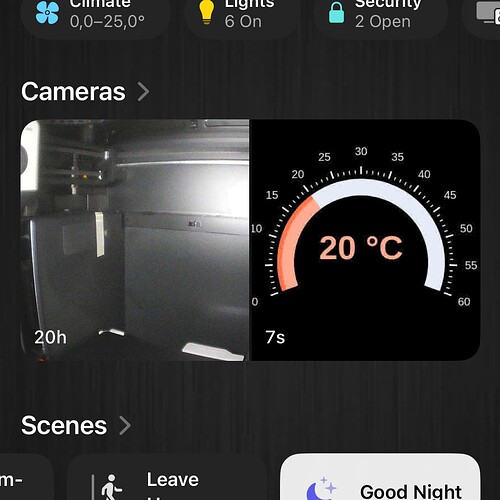

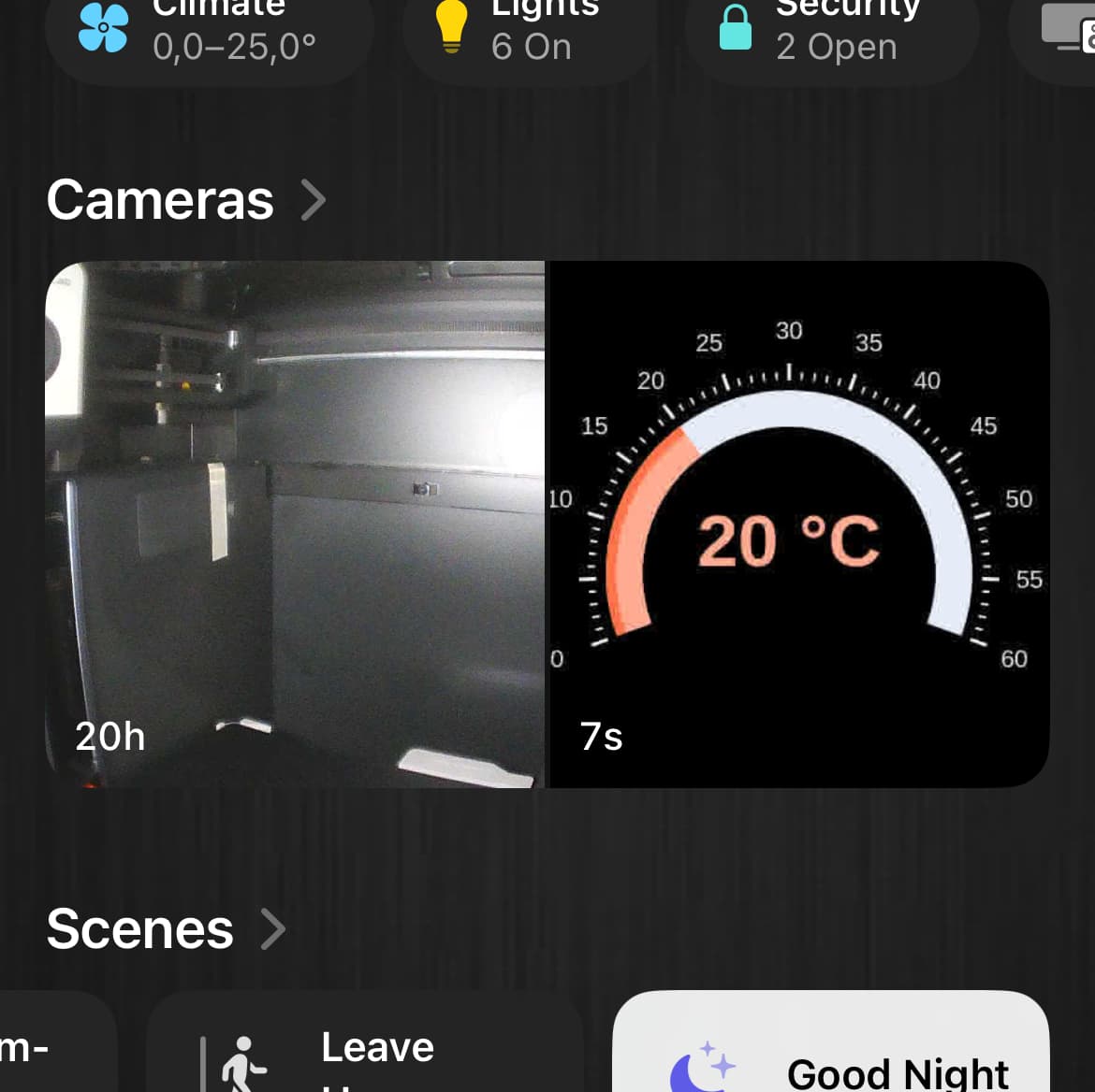

I create a webpage showing a chart, news headlines, or whatever I want.
Then use puppeteer to capture a screenshot of that webpage.
Feed the screenshot into pipe2jpeg to make it available as a stream.
This stream can be exposed to homekit (via homebridge) as a security camera:
Now I could create my own 'live station' of data i want to show, i noticed that i can kill ffmpeg and restart with another file and the stream will get updated.
ie: charts in homekit :laughing:
