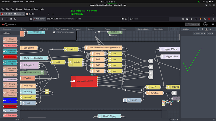

Just opened the subflow - a third time - and it is STILL missing wires!
Be right back with more soon.
Third/fourth? time lucky.
All the wires are now there on THAT subflow.
Still getting the rogue messages.
(Don't know if they should be a separate thread)
I quickly checked a couple of other subflows on that tab.... All seem ok.

I had a similar issue a while back , when moving code (incl subflows) from my dev machine to my prod. I check the code on a WIN and MAC machine and the lines were missing in both systems
A full shutdown of my PROD system solved the issue.

Base line:
Walk through
This is the part of the flow that does things.
The join points.... used to switch where the existing signal to go.
Up high is the exported insides of the subflow (green area)
Note time and debug window.
subflow input is NOT connected! (Important)
Also note the red/green lines showing WHO is connected.
Some time later.....
No errors.
Note how the wires have now moved and the top part is disconnected and the SUBFLOW input is now connected.
But note:
The subflow is still DISABLED
Now I'll press DEPLOY
Deployed.
Note times. 19:17
Time 19:18
ONE MINUTE
ERROR
subflow DISABLED!
Let's go further!
Wire removed to subflow.
Then DEPLOY
After deployment.
Errors wiped after I deploy to show any new ones.
NO errors.
Time passes.
No errors.
Note times.
Now let's look at it a bit more.
This is a copy of the subflow (duplicate) with some inputs.
DEPLOYED
Some time later.
No errors
More time.
No errors
I added a node to show the time, so you can see how long has gone by with no errors.
Injecting messages. Quite a few.
NO ERRORS
Still no errors
And still no errors.
and still none
Now we'll go back to the original subflow.
Note times, and wires into the subflow.
(yes a bit repetitive, but to show I am not hiding anything)
No errors
Move the wires and look at that!
ERRORS!
PLEASE....
