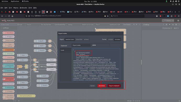

I'm exporting this function node.
Note node number.

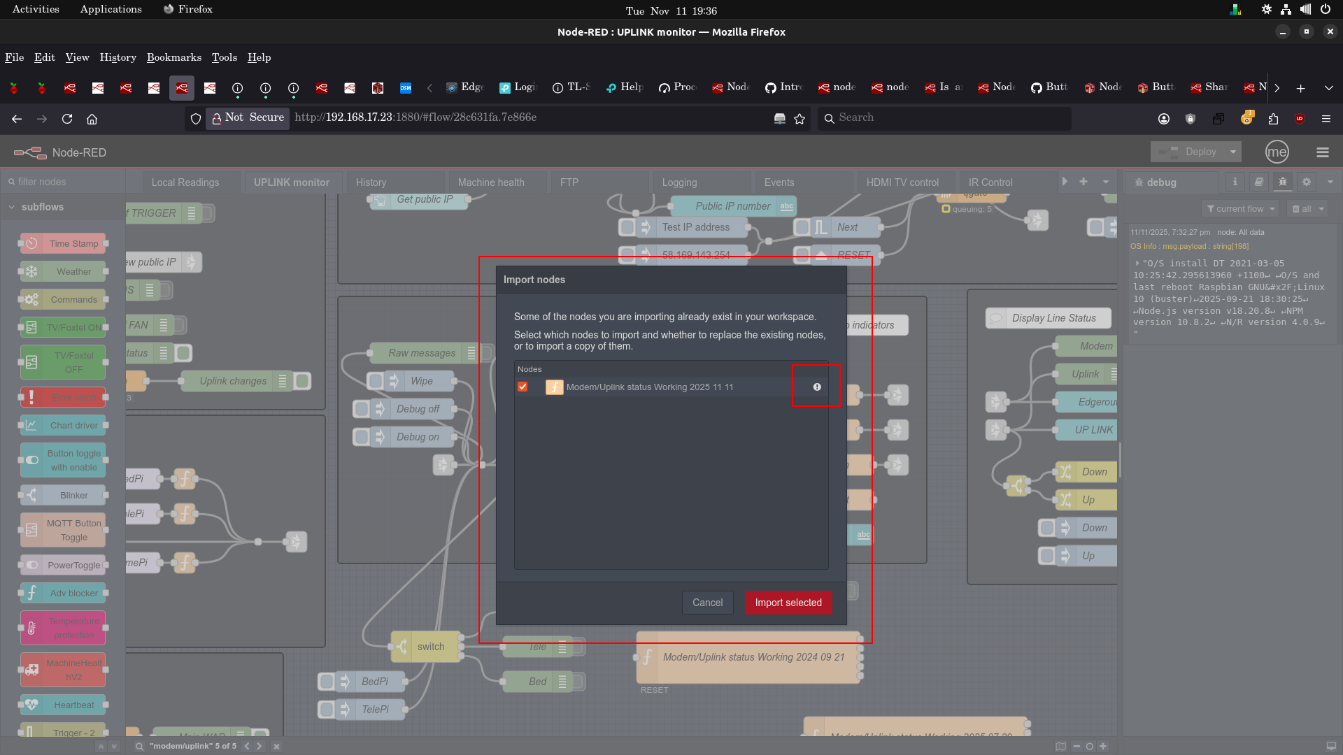

This is the machine into which I want to IMPORT it.
Pointing to node.
Note node-number. Same.
Paste code and press import
(I didn't post a picture of one option, but given I pick the correct one.)
I'm expecting to have the option to replace/overwrite the existing node.
But it isn't being shown.
This doesn't yet exist for an individual node.
It can replace a config node or a subflow only.
