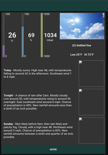

My first post and I've been using Node-Red for about a month now... IOW, a complete Noob. I have a question, but I don't know if it is really a Node-Red or Dashboard related problem.
Short Version

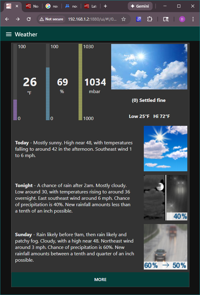

I have a dashboard tab that displays some images. It always works when viewed from a Windows machine using Chrome, an Android or iPhone phone. However, on an older Android, Nexus 7, redirected images don't show up.
Detailed Version
I have ESP8266 sensors around the house using MQTT to a Raspberry PI broker which also hosts the Node-Red server. The Node-Red Dashboard processes temperature, humidity and barometric pressure into bar graphs and into a MySQL database for historic usage. The tab also does a Zambretti analysis to predict the upcoming weather. The tab then displays an image for the corresponding prediction that is hosted on the Node-Red server. In the first picture below, this predicted, canned image is in the upper right corner. This image shows up on all devices.
Below the bar graphs, the tab calls the National Weather Service API to get the forecast for my location. In the returned data, it has URL's for icons representing the predicted conditions hosted on the api.weather.gov website. On Windows, a relatively new Android phone, and on an iPhone these redirected icons show up just fine. On an old Android, Nexus 7 (that is only good enough to be used as a fixed dashboard) these redirected images don't show up.
Does anyone have any ideas on where I need to modify something?
Thanks.

Can you see the icons if you try and access them from the browser on the old phone?

I should have thought of that. I tried the icon's URL on the device and the browser stated it was un-safe, yet all my newer devices were as happy as a clam with the URL. Anyway, I hit the Advanced button and proceeded to it anyway and it showed up as expected. As soon as I returned to the dashboard tab, they all showed up. I guess I approved the site for anything now.
Just for grins, I made sure the browser was closed, and re-booted. Going to the dashboard again and the icons showed up. I guess the browser has now retained that that is an acceptable site.
Thanks for your help.
