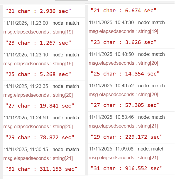

I timed a change node testing strings of 20 to 30 'a' characters followed by a bang aaaaaaaaaaaaaaaaaaaa! against regex (a|a?)+$ on a Raspberry Pi zero 2 (RHS) and Pi 4 (LHS):
Processing the regex consumed 100% of one CPU but it did not use all the memory, and the Pies did not throttle. I could still log in over ssh but the editor window was unresponsive and systemctl restart node-red did not interrupt the processing.
I wonder if this would make a useful component of a Node-red benchmark.
