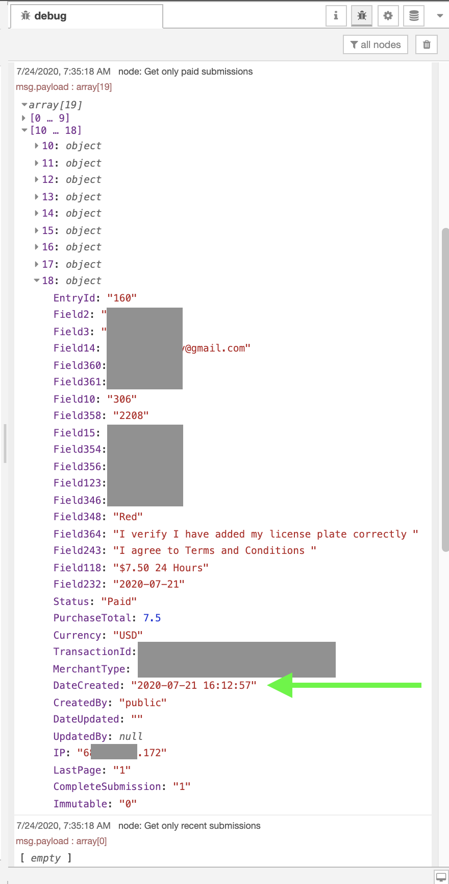

Remove JSON array items whose CreatedDate is not within last 5 minutes
I have a function ("get only the recent") to filter out JSON items from JSON array where CreatedDate was not created within the last 5 minutes.
OR to put it in another perspective.......
keep all JSON array items that have a CreatedDate within the last 5 minutes.
I am just missing something and I can't seem to see it.
var now  = new Date()
console.info("Now:                " + now);
var fiveMinutesAgo  = new Date()
fiveMinutesAgo.setMinutes(-5)
console.info("Filter by Date:     " + fiveMinutesAgo);
var permitDateTime = new Date(el => el.DateCreated);
msg.payload = msg.payload.filter(el => el.DateCreated.includes(permitDateTime.getTime() < fiveMinutesAgo.getTime()))
Put some debugging in using node.warn(). Like
node.warn("permitDateTime"+permitDateTime)
node.warn(el.DateCreated.includes(permitDateTime.getTime())
to get an idea of what the data actually is.
