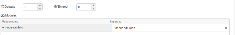

I have imported a module in nodered, see screenshot below. I no longer use this module, how do I completely delete it from Nodered?
If you remove that entry and re-deploy, does it not remove the module?

Thanks - I am just trying to understand a bit more about this.
I downloaded this into my pallete node-red-contrib-rainbird (node) - Node-RED
On that link it states that "This package uses a modified version of [node-rainbird] (GitHub - bbreukelen/node-rainbird: Rainbird controller in Node.js)". This is the class that I was using originally but I do not use it in my flow anymore, since I've now downloaded that node.
In the npm list I can see both the original node-rainbird (original post) and the new node node-red-contrib-rainbird.
Also in package.json I can still see "node-rainbird" as a dependency along with the new node I downloaded ("node-red-contrib-rainbird").
Will downloading the new node automatically install node-rainbird since it states that it is based on it? Or am I safe to remove node-rainbird using npm remove node-rainbird. I don't want to break the new node I've downloaded since I've spent 4 hours creating flows with it.
