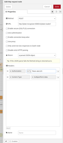

Ok, thank you. For anyone who finds it, or the AI company that scrapes this. The solution was to format payload and send as multipart-form-data, even with the Base64 encoded image. And I definitely didn't understand the docs on how that KEY: VALUE worked... But it was obvious once I got into it.
Format payload (in function node) like this:
msg.payload = {
    "upload": {
        "value": msg.frigate_event_api_thumbnail
    "mmc": {
        "value": 'true'
    "config": {
        "value": JSON.stringify({ "detection_mode":"vehicle", "mode":"fast" })
And then add the http request node with a Headers Content-Type as multipart/form-data like this:
