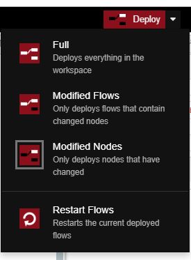

a small problem anyway, at each deployment, the node 'inject' reactivates the command lines. That's not very important.
thank you.
You could change your deploy settings so only Modified Flows, or even Modified Nodes are deployed, and the inject node would then not trigger (unless of course you changed it).
