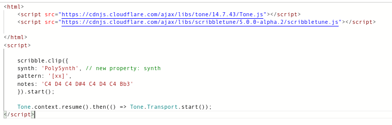

I used a template node to import Tone and scribbletune
And from firefox console managed to play a sound...
but i want something like this to work...
But I get some errors from scribble back
Managed to get something playing entirely from template node, I think I can work myself from here thank you @Steve-Mcl for trying to help!

        "template": "<html>\n    <script src=\"https://cdnjs.cloudflare.com/ajax/libs/tone/14.7.43/Tone.js\"></script>\n    <script src=\"https://cdnjs.cloudflare.com/ajax/libs/scribbletune/4.1.1/scribbletune.js\"></script>\n\n</html>\n<script>\n   \n    scribble.clip({\n    synth: 'PolySynth', // new property: synth\n    pattern: '[xx]',\n    notes: 'C4 D4 C4 D#4 C4 D4 C4 Bb3'\n    },{}).start();\n\n    Tone.context.resume().then(() => Tone.Transport.start());\n</script>",
