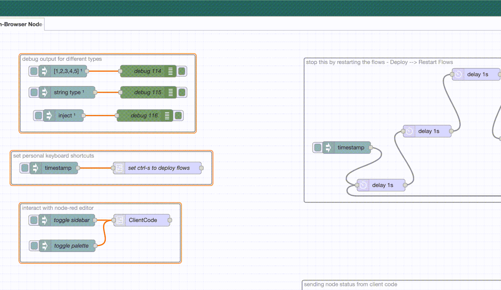

But then I discovered that the uses feature doesn't work or at least I couldn't get it working. So I debugged it. Eventually I figured out how the search works and that the uses flags should be used as a filter and not as a keys reduction value. Anyway, a made two other changes and now the feature is available over at Browser-Red.
uses-search2
