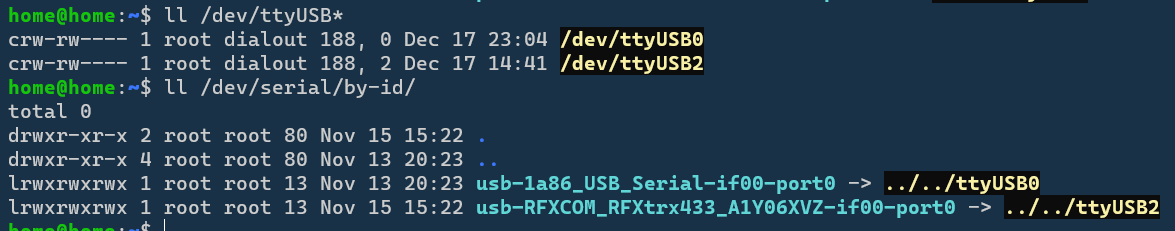

Look at:
and try one of those paths. That way, you wont get caught out if it changes.

OK, check the permissions next I think?
So if you are using the usual ttyUSBx devices, the user running Node-RED needs to be a member of the dialout group (assuming your config is the same). But if using the by-id devices, you shouldn't need any special permissions.

That should be /dev/serial/by-id/usb-1a86_USB2.0-Serial-if00-port0 as @TotallyInformation suggested.
Thanks you. Yes it is working now. This is a very good tip. I had 2 USB serial devices in the past and it made me mad whenever they changes places (ttyUSB0 <> ttyUSB1).
