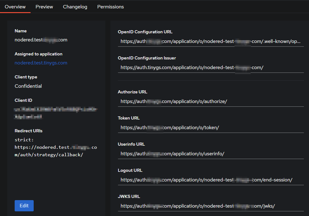

This is Authentik config data:

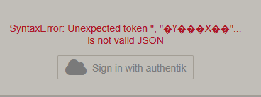

When logging in I get this error:
What can I do more in order to debug this?

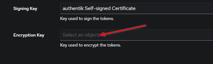

I had enabled token encryption in Authentik. I've disabled that and now error is: TypeError: done is not a function
