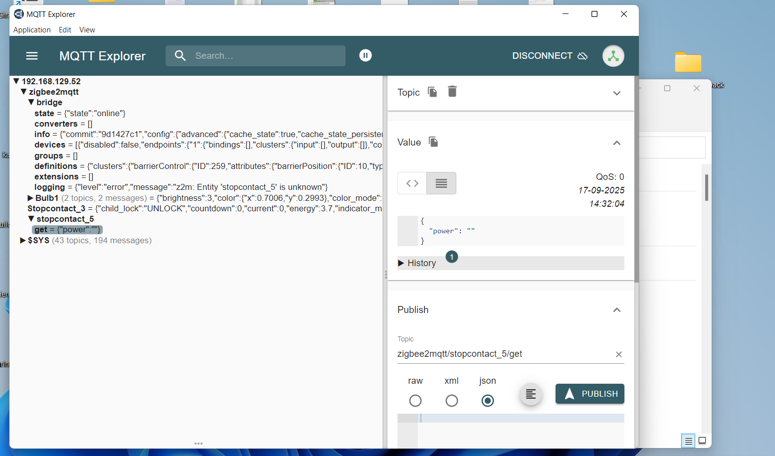

There is an excellent tool called MQTTExplorer, which is available for most OSs I think. Install that on your PC and then you can connect to the MQTT broker and see what is coming out on which topics.

and this is on the MQTT broker

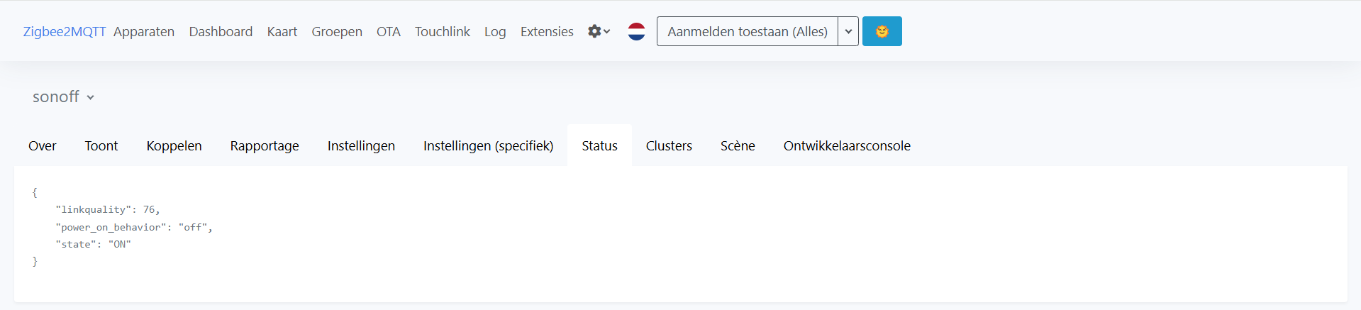

and this is the status in mosquito of the sonoff plug
and this is the status in mosquito of a nous plug

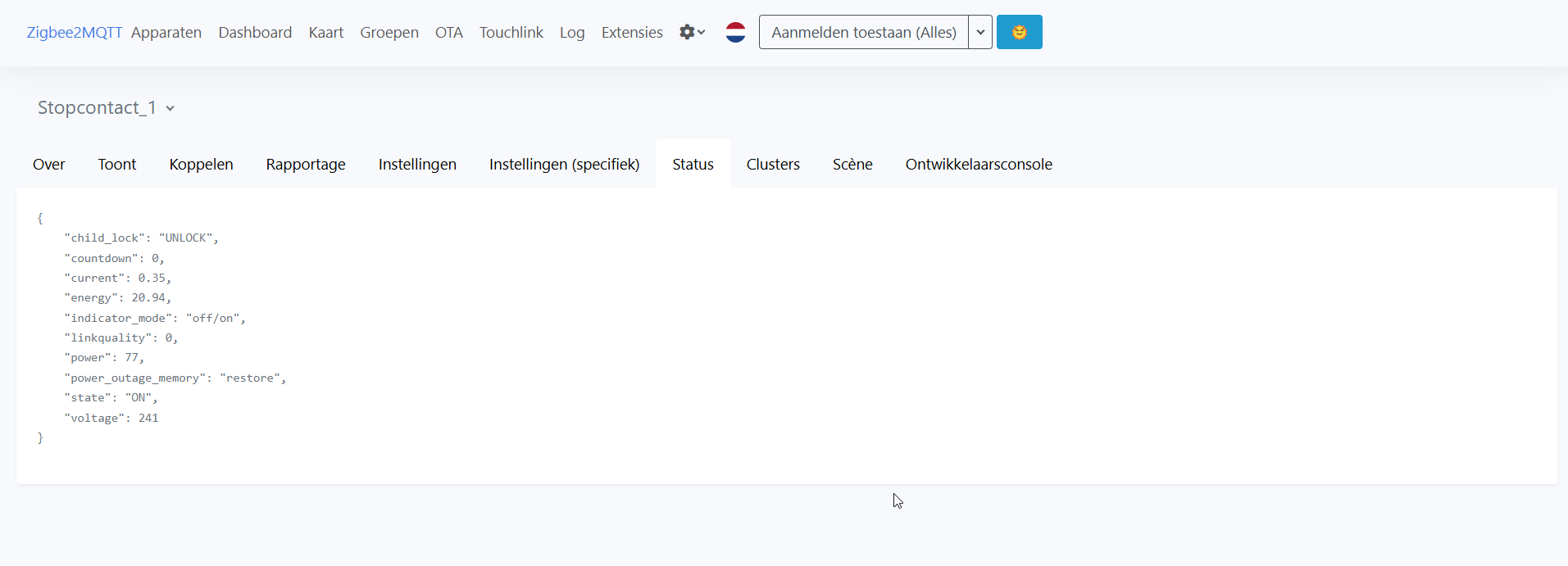

this is the rapport of the nous plug
this is from the sonoff

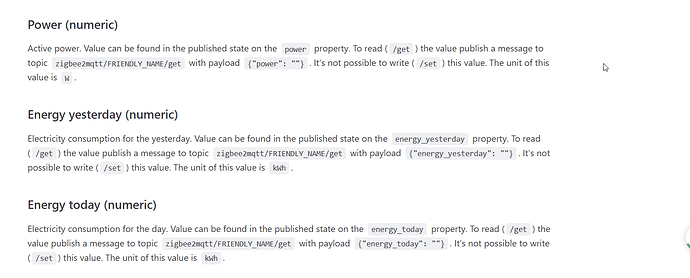

these , i want to retrieve

debug 45 gives nothing when i inject

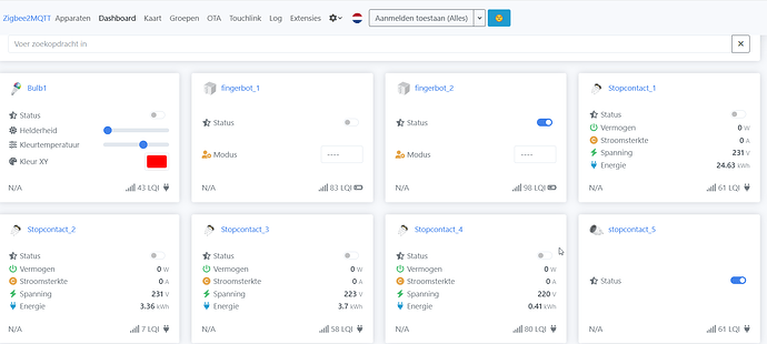

No, In the zigbee2mqtt web interface, the home page that shows all the devices on the network.
this one ?

goto github issues and search for S60ZBTPF
there seem to be some problems with this device
it seems to me it doesn't
support it

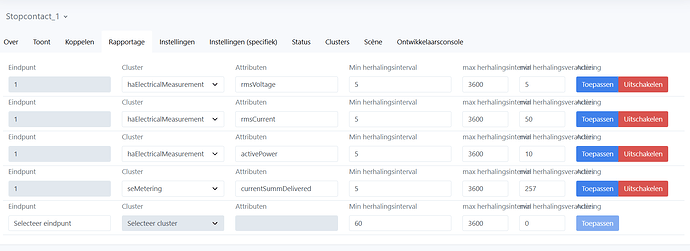

i try to activated in rapport but then i get this message.
UNSUPPORTED ATTRIBUTE

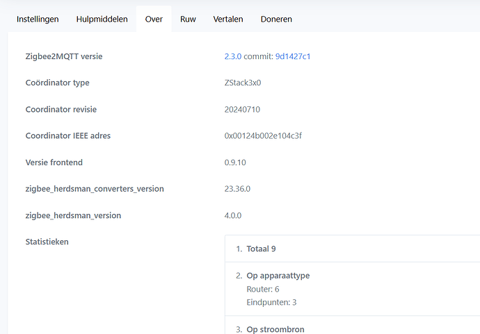

Which version of zigbee2mqtt are you using? Click the Settings cog then About. Current is 2.6.1 Releases · Koenkk/zigbee2mqtt · GitHub

i will update it.

Also note that you should not have to specifically ask for the current values, it should send them automatically. Hopefully the upgrade will fix the problem.
