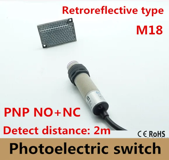

I'm not an expert but one that has a light on one side and a light sensor on the other. The plant would interrupt the signal as it passed.
http://www.wtec.org/loyola/opto/c6_s3.htm
Hundreds of variations on AliExpress:
https://uk.rs-online.com/web/c/displays-optoelectronics/optocouplers-photodetectors-photointerrupters/reflective-optical-sensors/
Wow thanks for the ideas! I have seen also the breakbeam sensors. My problem is that I have no idea how to communicate with it, without a pallete.
Looks like you need to work on some basics then.
If you are just using a Pi, you will need to understand how to connect the sensor to the Pi - not too hard as long as you pay attention to the voltage levels and current (some industrial grade sensors may require more current than the Pi itself can cope with).
