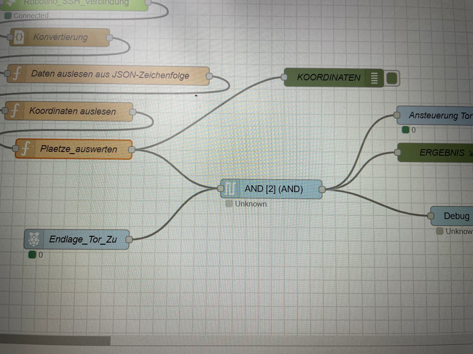

Now I have another Problem. I installed boolean for And/ Or functions. „Endlage Tor Zu“ is an Gpio In from my raspberry and it works with my and function but it doesnt matter if i give out an „True“ Or just a „1“ of my function, my and function doesnt Switch through it. There is always an „unknown“ under my function. Can u Tell me whats wrong with my function ?
Edit: msg.plaetze is wrong. Its also msg.payload
