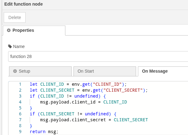

Thanks for your reply @marcus-j-davies .
I ended doing a logic inside the subflow with a function, to check if the env variables are completed or no. If yes, I replace the msg that is coming from the previous node with the value of the env variable:
With that, I allow the user to complete the needed values in the subflow/custom node properties, or pass them in the msg, because I’m using the name of the required messages as labels, so the user knows the needed “msg names”:
I’m going to add an additional logic to answer with an error if not all the required msg names / env variables are provided, but with this approach, I can accomplish my use case.
